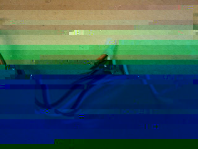

Yes, the mains are connected in parallel (See pictures below). It's not inside the sub anymore, and there was a fuse in there, but the actual wiring hasn't changed. You can see there's two pairs of wires going into the transformer. The sub works when 110 [V] is applied to the red+black pair (through the white wire) and the red+orange pair.

There are no markings at all on the transformer that I can see, except for what I presume is a QA stamp, which says "QC6/OK".
If I understand you correctly, connecting (say) the orange wire to the black wire currently connected to the red wire, and then connecting the 220 [V] mains to the red and remaining black wire would do the trick, right?

Can you clarify - are there 2 black wires, or is one brown - the picture doesn't show it well enough to be sure. The following assumes there are 2 blacks.
You should be able to connect the 2 primaries in series, however the windings should be in the same direction. The windings must also have been connected previously in parallel with both windings in the same direction, and since there is currently a black in each pair I think the 2 blacks will be opposite ends of each winding (one will be a 'start', the other a 'finish') - if you think of the 2 windings in a row the black wires will either be the 2 centre connections or the 2 outer connections.
Hence you need to join the 2 blacks together and connect the 220V to the red & orange. The fuse needs to halved in rating (twice the voltage so half the current). Check the output voltage with a multimeter before connecting it to the subwoofer. Also check the transformer is not excessively hot after it has been running for a while.

Apologies for not replying sooner, but I've only now had time to try your suggestion. And I'm happy to report this seems to do the trick! At least, when I wire the leads as you suggest, and apply 220 volts, I get the same voltages on the output as when I apply 110 volts with the original wiring.
